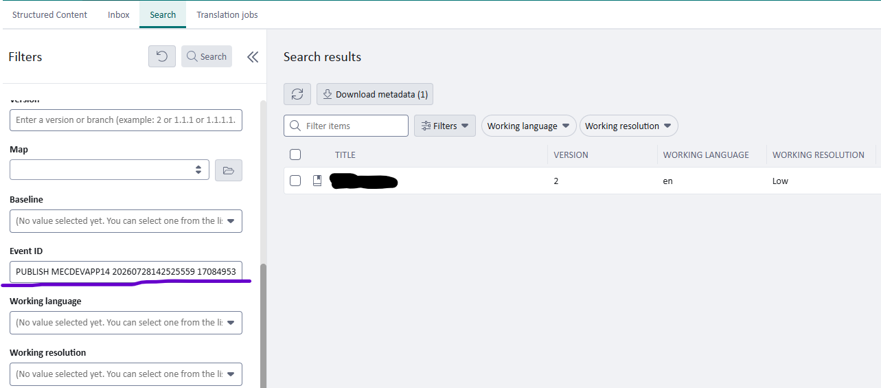

    As an alternative option with minimal customization, you can use the FISHEVENTID field on the Publication language level and search for it.
    For this, you need to extend the Search form for Publications with an extra Event ID field.
    To do this, you need to adjust your MetadataConfig.xml, which is usually located in \%Installation_Location%\Web_DeploymentName\Author\ASP\ClientConfig
    Find <ishfrm id="Trisoft.InfoShare.Forms.Searcher.SearchPublicationControl"> and add a new ishfrmfield
    <ishfrmfield name="PublicationEventIdField" ishfieldref="FISHEVENTID" level="lng">
    <label>Event ID</label>
    <description>External publishing event identifier.</description>
    <typetext />
    <fulltextsearchoperator>equal</fulltextsearchoperator>
    </ishfrmfield>
    You might need to restart your application.
    As a result your can copy the Event ID from the list of Events and use it in a search form.
