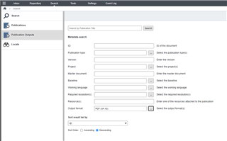

    Regarding OutputFormat usage, they are only used on PublicationOutput (so language level of publication versions). So those are the ones you should remove first, if you really want to delete this particular OutputFormat.
    Depending on the version of your software - the version is the shortest piece of information that describes how your system behaves.
    Either over here...
    Trados Studio interface showing the Publication Outputs section with various fields such as Publication type, Version, Project, Working language, and Output format.
    Since Docs 14SP2/14.0.2 you can also mark an OutputFormat as "inactive" which means it is still a good value for the CMS, but it is removed from any dropdowns when creating new PublicationOutputs.
