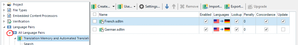

    1. Before creating your packages, go into the project settings and rather than having the TM's listed under All Language Pairs as seen below
    Trados Studio project settings showing Translation Memories listed under All Language Pairs with a red error icon indicating an issue.

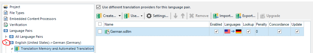

    2. Remove them and list the TM's directly under the specific language pairs as seen below
    Trados Studio project settings with Translation Memory listed under a specific language pair, English to German, with a red error icon.
    If I now create a package for German I will only get the German TM listed and not the French
