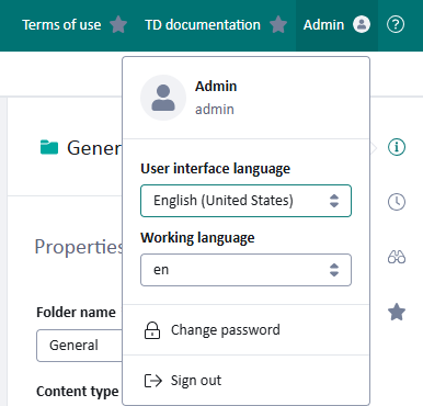

Rereading your issue, to my knowledge the standard product never had a "Forgot Password" option, the only option was a 'Change Password' (for which you need to know your earlier password). Below screenshot comes from 15.1.3 environment when authenticated over the built-in 'Tridion Docs Identity Provider' (which controls your password), and for completeness you can also see this link on https://ish.example.com/ISHID/
Organize Space enables extension points, like in the above screenshot for "Terms of use". Perhaps in the older web client somebody customized a similar behavior?
