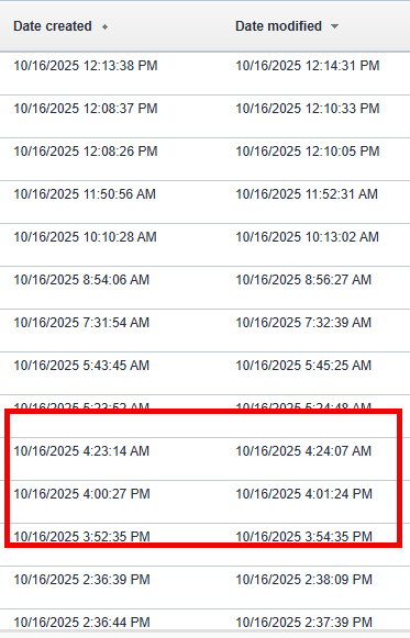

In 15.x, how are you finding specific event logs? The timestamps are wrong
In TDX 15.1 and 15.2, the event logs can no longer be reliably sorted because the timestamp behavior has changed. The "Date Created" and "Date Modified" columns now display the user-specific timestamps (the timestamp of the user that kicked off the event – not the timestamp of the user logged into the web UI to review the logs), so it's really hard to find the right log when you have a globally distributed team. It should sort by system timestamps only.
Has anyone come up with a workaround for this, or am I missing something fundamental?
  • It’s not about the users. It’s just that it’s not recognizing am and pm. So if I publish a job at 7:05 am and then you publish a job later that day at 7:00 pm, my job will always appear “later” than yours in the publish queue, even though it happened 12 hours earlier.A screenshot showing a table with columns 'Date created' and 'Date modified'. Rows are sorted by time, with a red box highlighting entries from 4:23:14 AM, 4:00:27 PM, and 3:52:35 PM.

  • We (Elizabeth and I) are using RWS Tridion Docs version 15.1.2/15.1.6328.2.
    The experience we had with the web client event viewer in Tridion Docs 14.x and earlier was event times were fixed to the location of the server, using a 24 hr clock. And the events were ordered properly (the most recent events were shown as the most recent events in the table).
    Now, when we review publish and other events in Organize Space, the event times are fixed to the location of the server using a 12 hr clock (using am and pm). Hovwever (I assume due to the clock change) the event times that appear in the table are all over the place as described above. If I publish a job at 7:05 am today and then publish a job later today at 7:00 pm I expect the 7:00 pm job to the shows as more recent. But the table lists 7:05 today as later than 7:00 today because it's ignoring am and pm. That is the issue that needs to be fixed (at least in our Organize Space). There is no problem with the ordering of dates, just event times in a day.
  • Thanks Tyrone for the full version number.
    Combining the last two messages, you should still have the wanted 14.x behavior on your 15.1.2. Your system is incorrectly setup, please contact your system administrator.
    The date time format is set to English (United States). And that screen layout is rendered by the somewhat older ASP.NET MVC engine - hence 15.1.x or earlier. This must be set to English (United Kingdom) as stated in step "Set the language and region of the InfoShare user" of https://docs.rws.com/en-US/tridion-docs-main-documentation-1151795/establishing-a-dedicated-system-user-127303 In turn 24-hour clock is sortable. [SRQ-28150]
