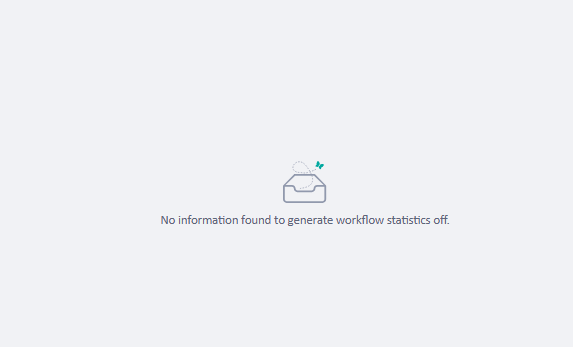

Unable to access Workflow reports in 15.1. We get a message "No Infomration found to generate workflow statistics off." How would I enable this feature?

Hi Akheil,
This is message is not caused by a feature toggle, but it indicates that the publication for which you want to create the workflow statistics does not contain any actual baseline information.
Can you make sure that your publication has a baseline with selected versions for the included objects?
Kind Regards,
Hi Raf,
Thank you for your prompt response, I was able to validate the publication has an baseline with selected versions. I didn't see any errors thrown in the logs. After looking into it further I noticed that the XML Settings | Reports was empty. After copying the xml for Reports from the server(Admin.XMLReportConfiguration.xml) the workflow report started working.
