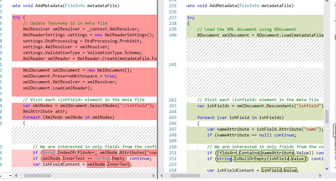

  •   All the recent coding work we have been using XDocument looks like all those custom plugins are working well.
    Only the plugins which has XMLDocument instead of XDocument were throwing this error. So I suggested them to use XDocument instead which is working.
    The most commonly use PS plugin InfoshareRenameFiles has same issue as well. We will need to rewrite those XMLDocument calls there as well.
    Screenshot of code comparing XMLDocument and XDocument implementations. Left side shows XMLDocument with XmlReader, right side shows XDocument with Descendants method.
