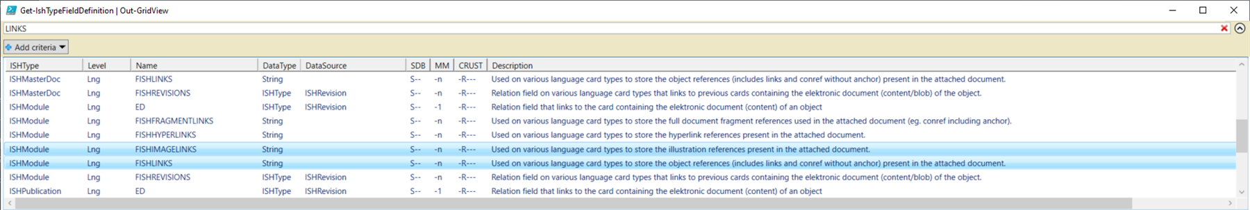

    If you want more object type and field type information, please try ISHRemote cmdlet: Get-IshTypeFieldDefinition | Out-GridView ... what you can also derive here under header CRUST (Create-Read-Update-Search-Tagging) is that all LINK fields are not part of Search, so they are not part of the FullTextIndex and can hence not be queried under API25.Search. So you'll have to go over API25.DocumentObj.Find (or ISHRemote Find-ISHDocumentObj)
    Screenshot of Trados Studio's Get-IshTypeFieldDefinition Out-GridView showing a list of LINKS with fields such as ISHType, Level, Name, DataType, DataSource, and CRUST with descriptions for each.
