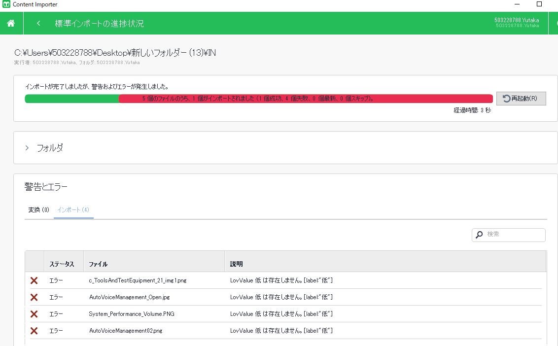

I tested to import the simple topic with several images using Content Importer.
In this case, it failed with the error "invalid character in line 1, position 1" for all image.
I asked my colleague to do the same. He encountered the same error for jpg file only.
png file could be impored without any error.
Any suggestion to resolve this issue?
  • It seems like this issue was cased by Japanese setting of Tridion Docs UI.
    After I changed the language to Engilish from the following menu, this problem was resolved.
    Tridion Docs Publication Manager -> Tools -> Options
    I found the Japanese charactor "低" in Trisoft.ContentImporter.config.
    (%USERPROFILE%\AppData\Local\SDL\InfoShare Client\14.0\Trisoft.ContentImporter.config)
    I don't know if it is the reason, but I start douting the Japanese setting of Tridion Docs because of it.
    If this is true, I hope this problem will be fixed in Tridion Docs software side.
    Thank you.
