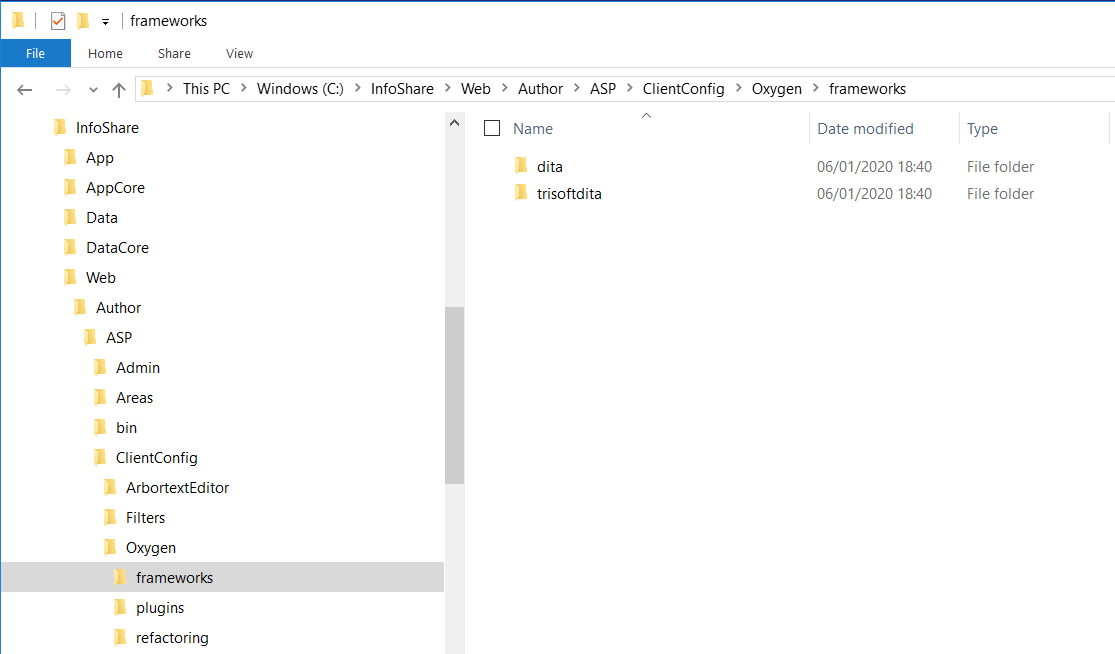

  • Our SyncInfo.xml for the Oxygen customizations is as follows:
    <syncgroup>
    <syncfolder serverfolder="~/ClientConfig/Oxygen/" clientfolder="C:\Program Files\Oxygen XML Author 20\" />
    </syncgroup>
    We synchronize both dita and trisoftdita frameworks as shown the screenshot below.
    File Explorer window showing two folders named 'dita' and 'trisoftdita' within the directory path 'C: InfoShare Web Author ASP ClientConfig Oxygen frameworks'. Both folders have a 'Date modified' of '06012020 18:40' and are of type 'File folder'.
    Hope this helps you.
    Naoki
