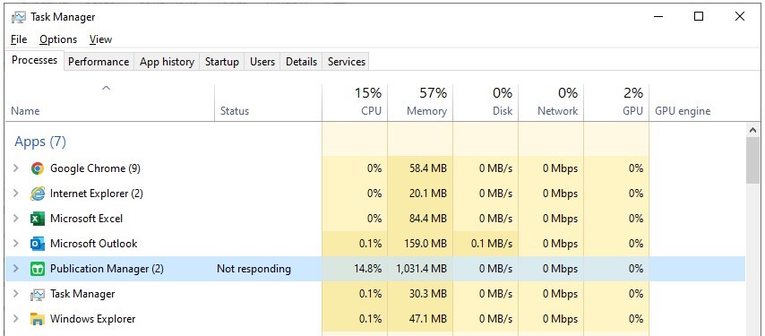

These imports end up being used to create very large publications, as well. We have trouble opening them even when increasing timeout settings. A baseline may have 15,000 objects and we see "spinning cursor" for many minutes at a time. Navigation and doing simple tasks in Publication Manager in these large publications are also very difficult and slow.
