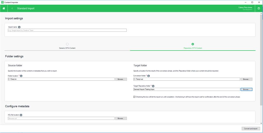

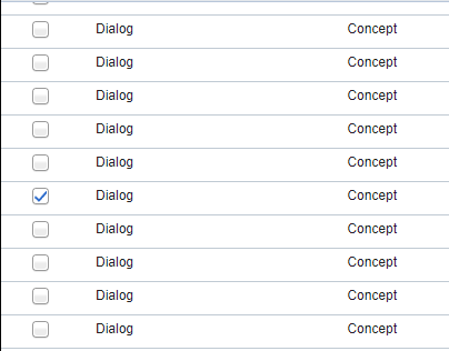

I want to replace UI elements (uicontrol and wintitle) with variables. I have a topic with a title "<wintitle>BPC Options</wintitle> Dialog". See BPC Options Dialog-no-variable=GUID-xxxxxxxx-xxxx-xxxx-xxxx-xxxxxxxxxxxx=4=EN=.xml. Its title in the database is "BPC Options Dialog". I downloaded the file and replaced the "BPC Options" with a variable with a script (I want to be able to process many files, so we created a script). See BPC Options Dialog-variable=GUID-xxxxxxxx-xxxx-xxxx-xxxx-xxxxxxxxxxxx=4=EN=.xml. Then I imported the file with Content Importer (Standard Import/Repository Content). See the image of the Content Importer. Then name of the topic in the database changes to "Dialog" (the variable is ignored). Is there a way to prevent the topic name from changing?
Screenshot showing a list of topics in Trados Studio with the topic name 'Dialog' selected, indicating the variable replacement issue.
Screenshot of the Content Importer interface in Trados Studio with fields for import name, folder location, and metadata configuration.
