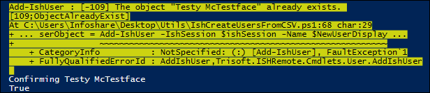

Without the Try/Catch/Finally block (i.e. just Add-IshUser and no error handling), new users are created, but for existing users we get this error and nothing happens to them:
PowerShell error message indicating 'Add-IshUser : -109 The object 'Testy McTestface' already exists.' with a path to the script file and line number.

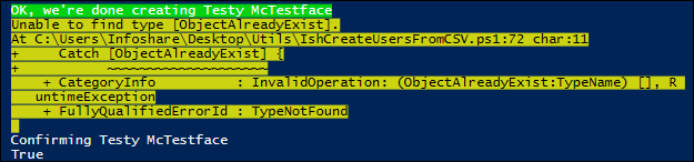

Presumably we use Set-IshUser to update existing users, but we need to set up an if...then condition. Google tells me the cool PowerShell kids use Try/Catch/Finally, so I added the coloured blocks in the sample code. We now get:
PowerShell warning message stating 'Unable to find type ObjectAlreadyExist.' with a path to the script file and line number, indicating a type not found exception.
Something is clearly happening. We see Finally's "we're done" message followed by the clear failure of my condition in the first Catch. (Umm... what's with that order?)
I've experimented with various things in the square brackets, but clearly don't understand the point. (Something to do with 'type'.)
