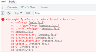

  • Hi Dave,
    Thank you for the response, the field was setup as a multivalue in DBUT and does have multivalue set in metadataconfig, still no luck. We have the latest version of Tridion Docs 14 SP3 and latest Draft/Review Spaces. Looked at the Developer tools while trying to set value on a metadata bound field and I get the following error.Screenshot of Trados Studio error message in Developer tools console stating 'Uncaught TypeError: e.reduce is not a function' with red error icon and code references.
