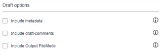

Here is the UI Field added into the screen:
Screenshot of Trados Studio UI showing the 'Draft options' section with a new checkbox field labeled 'Include Output FileMode'.
i am not sure what i am missing here,
Please guide me here on what i am missing here. I followed the steps exactly mentioned in the documentation. Is there any other steps which i am missing.
