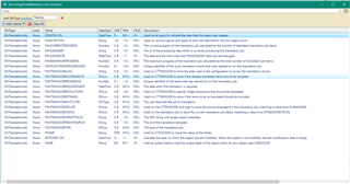

    In order to know which name/level combinations are valid for which object types, you can use the ISHRemote powershell library.
    Executing the following commands from it will present all of the available fields with their respective levels for the different object types.
    1/ New-IshSession -wsBaseUrl "">yourmachineurl/ISHWS" -PSCredentials Get-Credentials
    (provide in the prompted login box username and password to connect towards SDL Tridion Docs
    2/ Query for the fields defined by the object types using
    Get-IshTypeFieldDefintion | out-gridview
    (this will build the list and make it available in a filterable and sortable grid. See screenshot below.
    Screenshot of Trados Studio's ISHRemote PowerShell library output displaying a list of fields with their respective levels for different object types in a filterable and sortable grid.
    I hope this helps,
