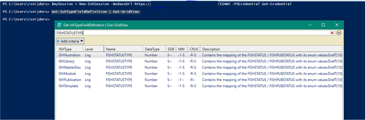

  • Hi Dhruv,
    The FISHSTATUSTYPE is an internal field available for the following object types: 'ISHModule', 'ISHLibrary', 'ISHMasterDoc','ISHIllustration','ISHTemplate' and 'ISHPublication'. So on ALL object types.
    You might be confused by the FISHPUBSTATUS which is only available on the object type 'ISHPublication'.
    You can verify this by using ISHRemote and follow the procedure below:
    1. Create a new session linked to your environment
    $mySession = New-IshSession -WsBaseUrl https://<your machine reference>/ISHWS -PSCredential Get-Credential
    2. Provide the username/password combination (of an administrative user) in the popup window
    3. Request to retrieve all field defintions
    Get-IshTypeFieldDefinition | Out-GridView
    4. In the Gridview popup window filter based upon the value FISHSTATUSTYPE (put this in the textbox with the placeholder text 'filter'.
    The result should be as shown below which shows that the field FISHSTATUSTYPE is available on all 6 object types listed above (foreach object type it is available on the language level)
