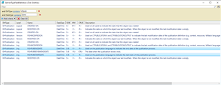

My first suggestion would be to check the fields that your particular CMS version has to offer.
