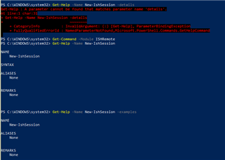

I tried Get-Command -Module ISHRemote but nothing was returned. The Get-Help -Name New-IshSession worked fine but the examples didn't return anything different. There was no help regarding arguments. Do I need to install anything beyond ishRemote to get the help to work?
I was able to get t the help via the IDE. It had to do a download. Once that was done, the commands you provided worked. Thx

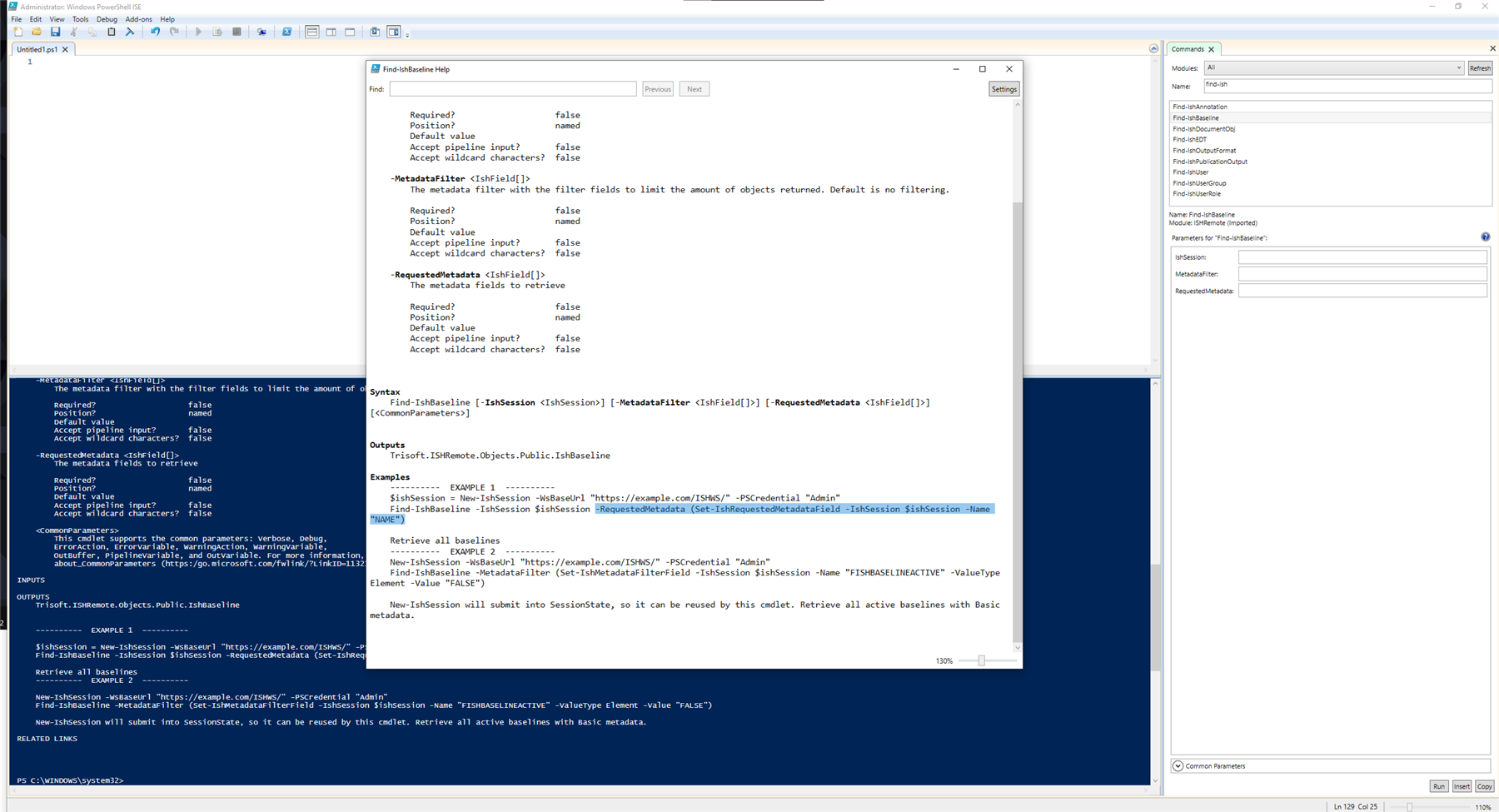

If you use "Get-Help Find-IshBaseline -Full", so -Full instead of -Detailed, you also get examples and those might help you forward as well. Although a bit outdated I still like the Commands navigator panel in PowerShell ISE (integrated script editor) for browsing a PowerShell module - see screenshot below.
The IshField[], or IshField object array, is a container to group API concepts like Requested Metadata, Filter Metadata and Retrieved Metadata. It is very closely related to the public SOAP API containers, wrapped in a PowerShell syntax, as you can see on TD14SP4 - Baseline 2.5 Find ... There are cmdlets on how to create these containers as you will see in the samples.
