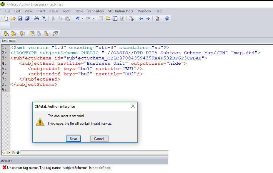

  • Quick background: We do *not* currently have any subscheme objects in our CMS. We are attempting to add a subjectscheme object to our CMS, however it appears the DOCTYPE is not currently supported. I'm assuming some configuration must be done to support this DOCTYPE or perhaps I'm doing something completely wrong.
    Here are the details:
    1. We're using SDL Tridion Docs Build 13.0.4115.1.
    2. Yes, I can see a catalog-dita.xml file under /Web/Author/ASP/DocTypes/ that has been configured. However the current "Subject Scheme" entries do *not* include <!DOCTYPE subjectScheme PUBLIC "-//OASIS//DTD Subject Scheme Map//EN" "map.dtd">. The entries present  are as follows:

    3. Yes, SDL Tridion Docs Publication Manager / Web Client / XMetaL 12.0.
    4. What's not working is we are attempting to add a subject scheme object to our system is that XMetaL/SDL indicates the DITA is not valid or unknown and throws an error message. We believe this is because the DOCTYPE is unknown. A screenshot of the error example is attached.Error message in XMetaL Author Enterprise stating 'The document is not valid. If you save, the file will contain invalid markup.' with options to Save, Cancel, or view the full error report.

  • Thanks for the answers. Can I assume you know about TD13SP2 - Configuring a DITA specialization for use in XMetaL and the sibling topics - if so then it is reference for other people finding this thread.
    Tip, if you can do it over XMetaL then probably the whole stack works. You could start however by uploading over the Web Client as that focuses on verifying your catalog/DTD configuration.
