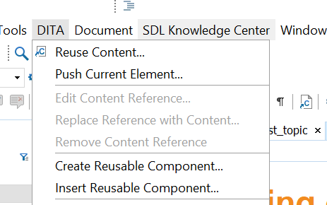

  • Are any of the conref commands available off the Oxygen DITA menu compatible with SDL?
    Dropdown menu in Trados Studio with options for Reuse Content, Push Current Element, Edit Content Reference, Replace Reference with Content, Remove Content Reference, Create Reusable Component, and Insert Reusable Component.
