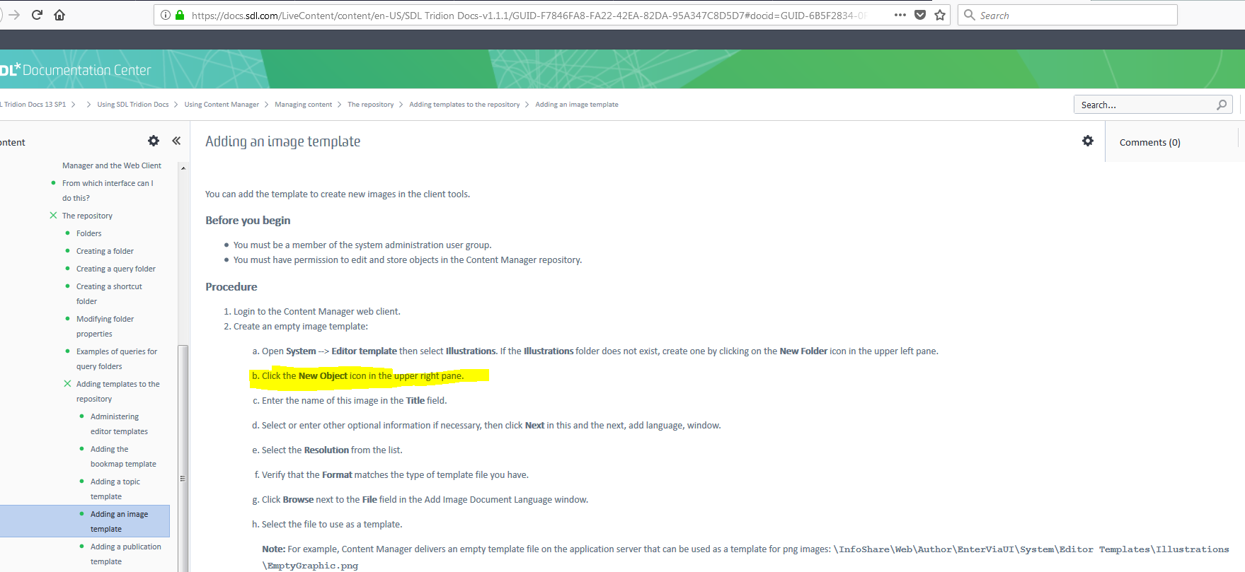

I m trying to add image template in SDL Tridion docs 13.
I m following below steps.
https://docs.sdl.com/LiveContent/content/en-US/SDL%20Tridion%20Docs-v1.1.1/GUID-xxxxxxxx-xxxx-xxxx-xxxx-xxxxxxxxxxxx
Screenshot of SDL Tridion Docs online help page with step 2 highlighted, showing instructions for adding an image template.

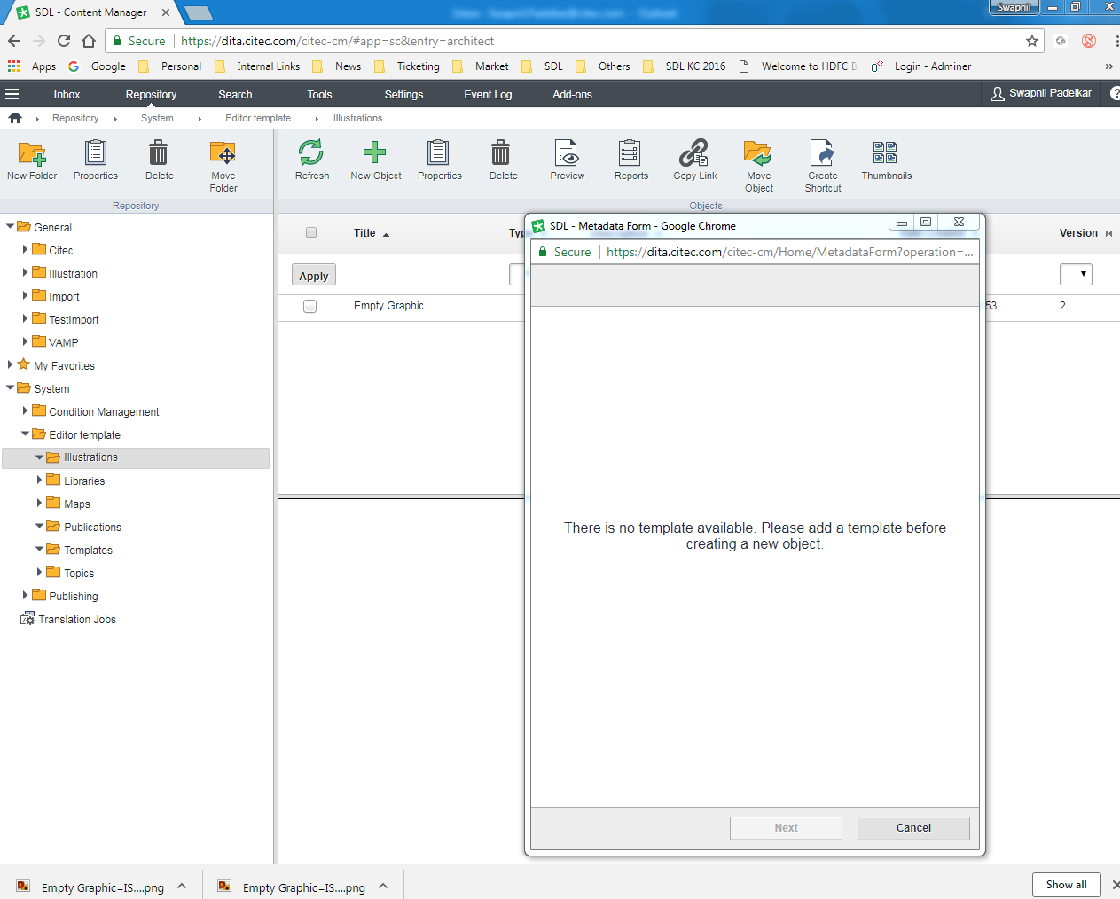

When i follow step 2--> b,  i got below error.
Error message in SDL Tridion Content Manager dialog box saying 'There is no template available. Please select a template before continuing.'

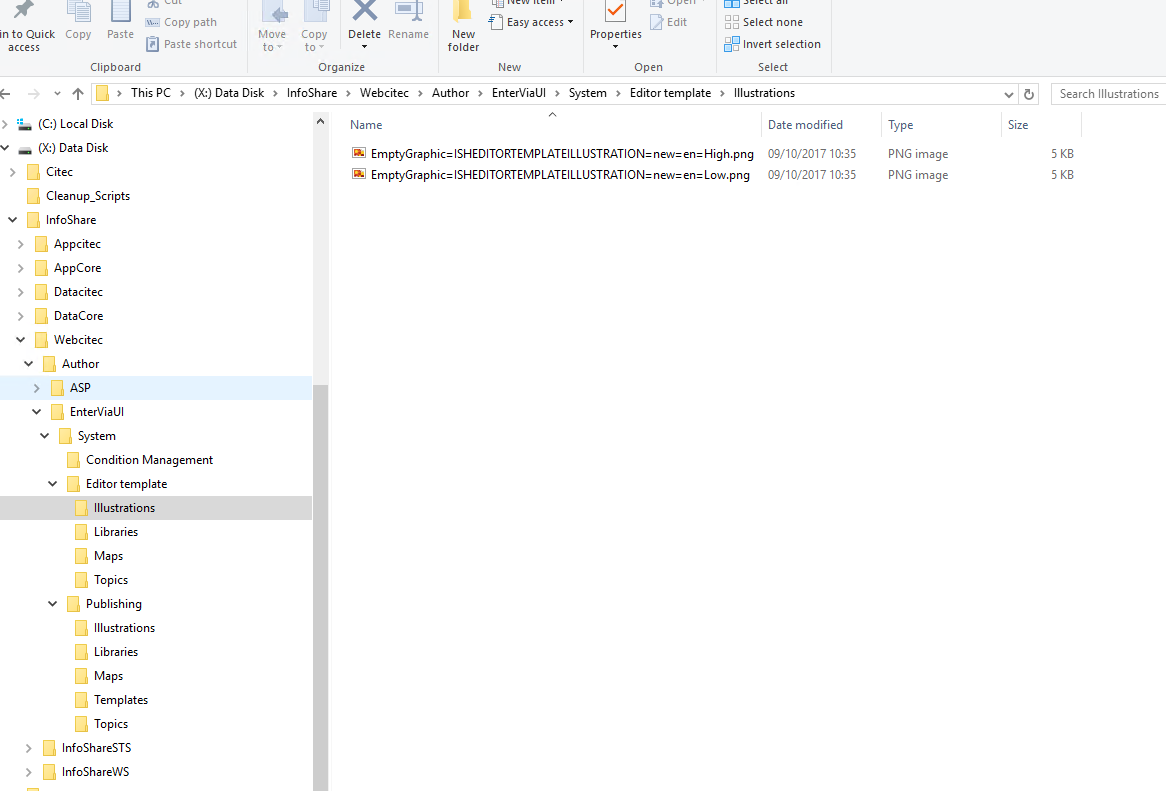

Also there is sample file available in folder  \InfoShare\Web\Author\EnterViaUI\System\Editor Templates\Illustrations\EmptyGraphic.png.
Windows file explorer showing the directory path to the EmptyGraphic.png file within the Editor Templates folder of SDL Tridion.

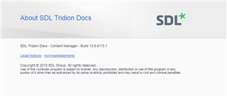

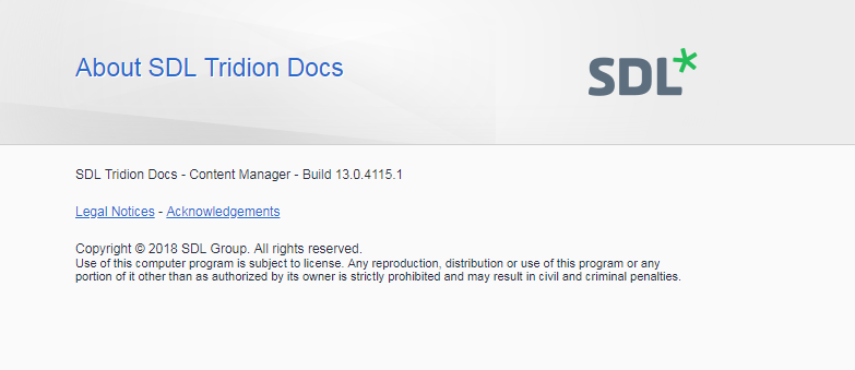

  • Hello Dave
    Please find the version details.
    Screenshot of the 'About SDL Tridion Docs' window showing the version as 'Content Manager - Build 14.0.4115.1' with SDL logo at the top.
    [edited by: Trados AI at 6:34 AM (GMT 0) on 5 Mar 2024]
