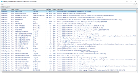

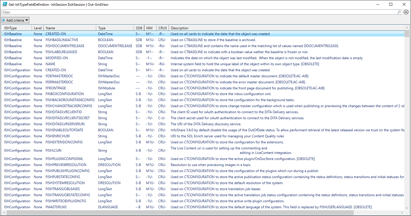

    Yes there is... Using ISHRemote in PowerShell ISE... Try
    $ishSession = New-IshSession -WsBaseUrl "https://example.com/InfoShareWS/" -IshUserName "username" -IshUserPassword  "userpassword"
    Get-IshTypeFieldDefinition -IshSession $ishSession | Out-GridView
    It returns you a nice grid view with filtering capabilities
    Screenshot of Trados Studio's PowerShell ISE showing a grid view of ISHTypeFieldDefinition with various fields and data types listed, including descriptions and user constraints.
    Within PowerShell have a look at the help of the above cmdlet
    Get-Help Get-IshTypeFieldDefinition -Full

  • Hi Mark,
