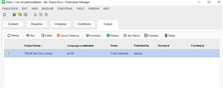

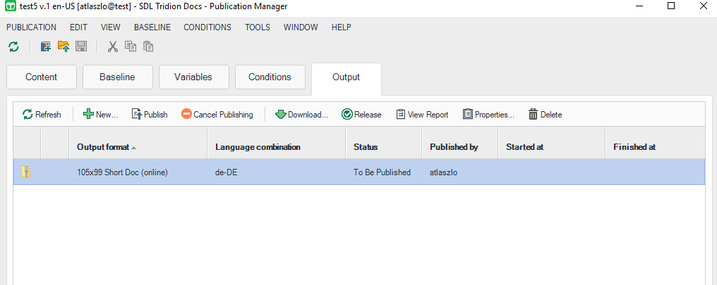

Trados Studio Publication Manager showing an output format list with a single entry set to de-DE language and 'To be Published' status.

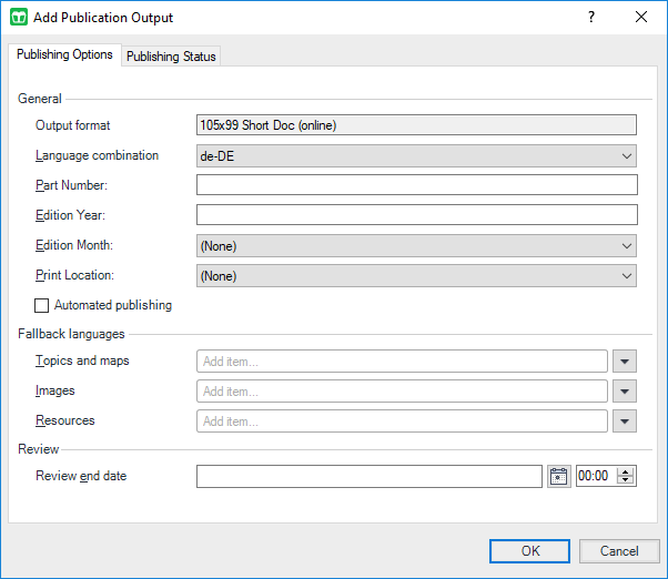

If I am creating another new output format, I get this window:
Add Publication Output dialog in Trados Studio with output format '125% Short Doc (online)' pre-selected and language combination set to de-DE.
Which would be expected for the first creation also..
The only difference I found between the Pub Manager 12 and 13 UI is that in the Language combination combobox (on the Add Publication Output window) , there isn't the "Choose an option" possibility. Maybe that's why it choose automatically the first one (which is the de-DE)?
