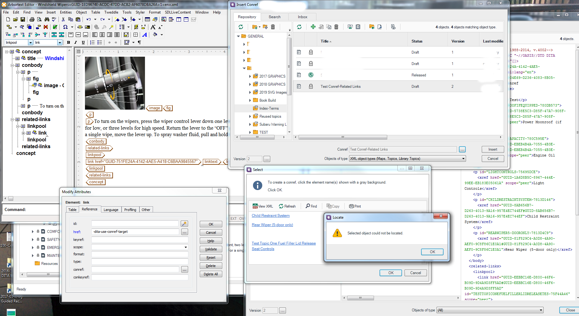

Nothing I have tried will get Arbortext to make a link element "selectable" in the conref inserter dialog -- even when I am certain that I am in the correct context.
I don't know if this is an Arbortext issue or an authoring bridge issue (I suspect the latter).
I can get the conref inserted properly by manually editing link elements in the related-links section, having to resort to "edit XML source."

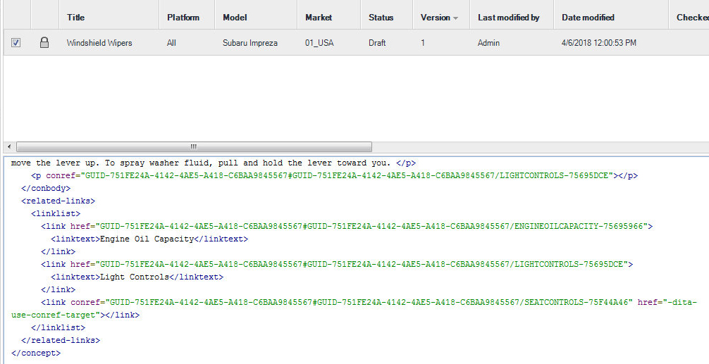

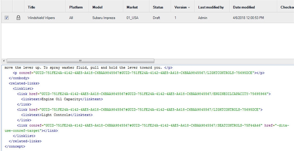

  • And here is the topic in which I am trying to create the conref. I eventually got it created (what you see below is valid) through very manual editing (i.e. edit XML source). I check out this topic from Pub Mgr. It opens in Arbortext 6.0. I go to insert markup (<link> element), and select conref from the Arbortext modify attributes dialog. I am not able to select the target from the other topic in that conref dialog.
    Screenshot of Trados Studio showing XML source code with conref elements and related links for a Windshield Wipers topic in a draft status, last modified by Admin.
    [edited by: Trados AI at 6:30 AM (GMT 0) on 5 Mar 2024]
