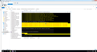

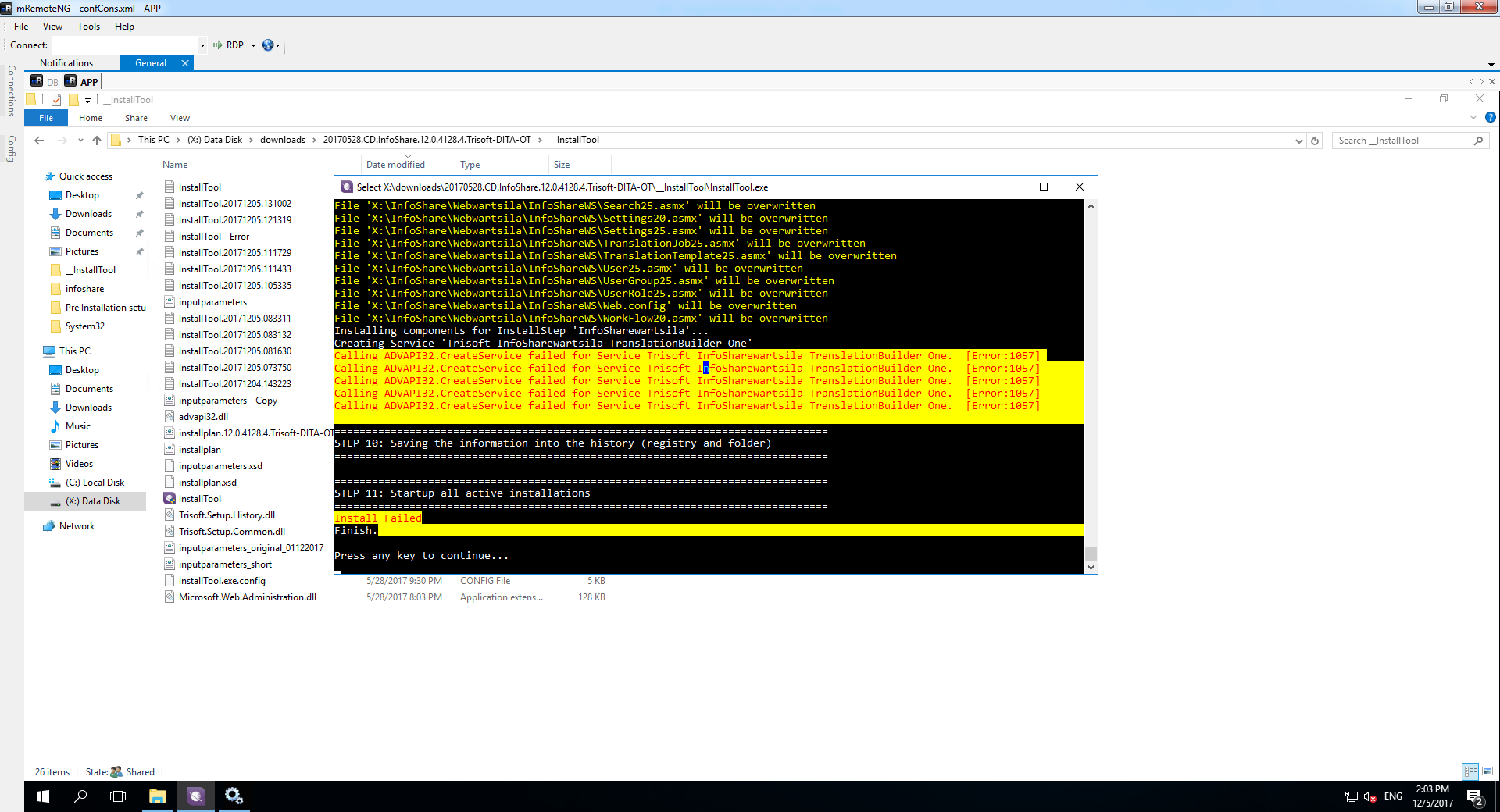

While installing Inputparameter.xml by using installtool.exe i m facing below issue.
Preferably this should go over customer support as these issues can cluster around OS/Windows updates.
Now in this particular situation the Windows Service registration by Microsoft ADVAPI32 failed with error 1057. Googling will quiclly get you https://msdn.microsoft.com/en-us/library/windows/desktop/ms681383(v=vs.85).aspx
ERROR_INVALID_SERVICE_ACCOUNT
1057 (0x421)
The account name is invalid or does not exist, or the password is invalid for the account name specified.
Hope this helps
