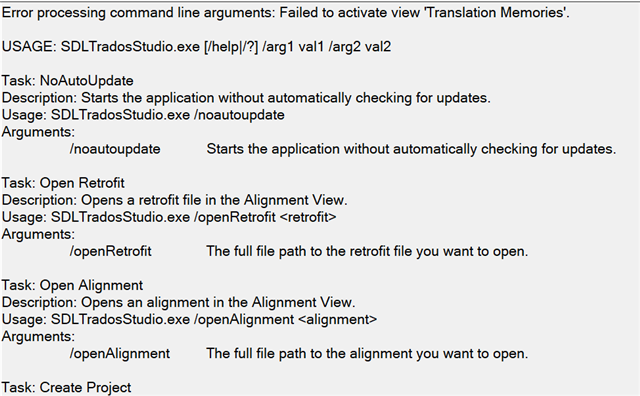

    I've now got from the PM the sdlppx-files and the TM as an sdltm-file. I've now managed to load the sdlppx-files, but when I tried to load the sdltm-file, I got the  message, you'll find attached.

    "I've now got from the PM the sdlppx-files and the TM as an sdltm-file. I've now managed to load the sdlppx-files, but when I tried to load the sdltm-file, I got the  message, you'll find attached."
    You cannot add anything to the PPX -
    Ie. you cannot upload a PPX in Studio and then add an additional file. (this explains the error message).
    You would indeed need to either:
    1) contact your client and ask for a new PPX- this time with the TM included in the PPX package (recommended).
    2) unzip the PPX outside of Studio (you WILL  need the clients prior consent though for this!) then add the individual files and TM in to your own project.
    Using this method will mean you are NOT able to send a return package though.
    Let me know if this helps.
