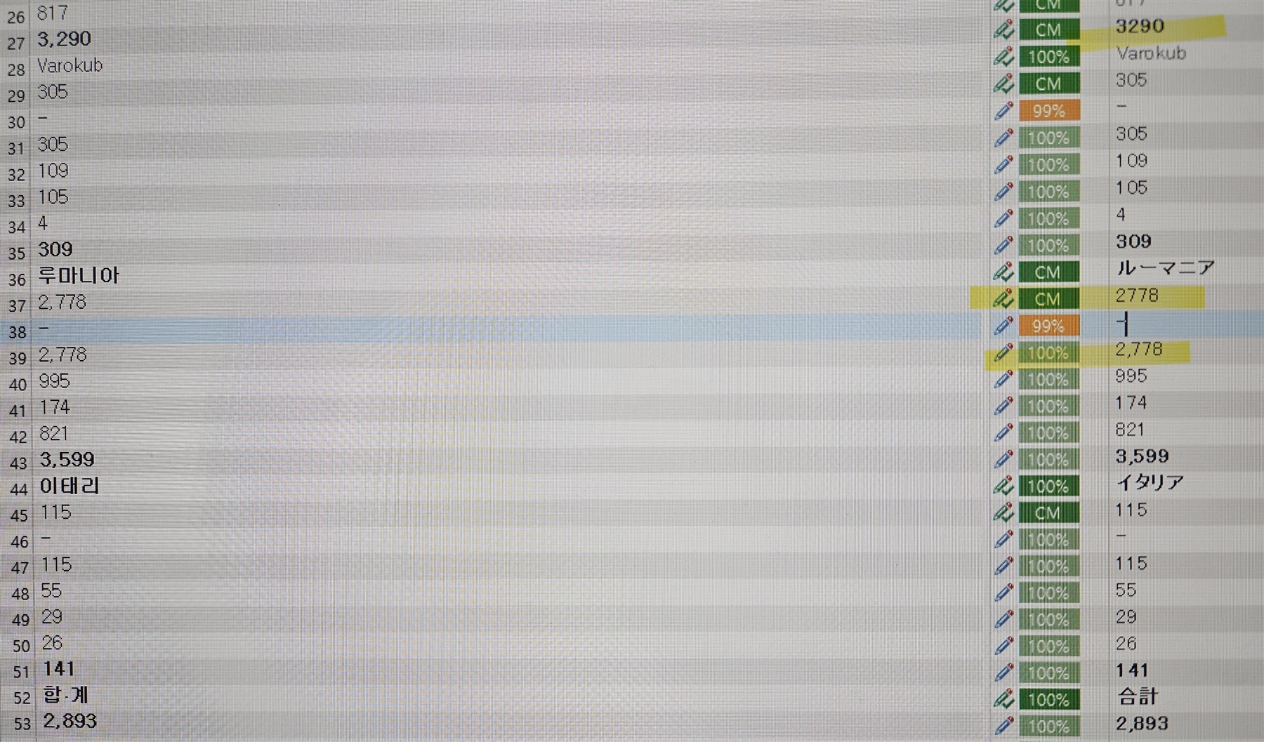

  • korean -> japanese번역중이며,
    다른 통역사들의 TM과, 구글 기계번역기를 걸어놓고 사용하고 있습니다.
    아래 사진과 같이,
    단위나 문자 없이 오직 숫자만 있는 세그먼트일때,
    처음엔 [100%]상태이다가
    ctrl+enter로 다음 세그먼트로 넘어가는 과정에
    아래쪽에 있는 숫자들이 자동으로 [CM]으로 번역되면서, 숫자의 ","가 사라집니다.
    (회사보안상 인터넷 첨부가 불가능하여, 사진찍어서 올리는 점 양해 부탁드립니다)
    Screenshot of Trados Studio showing a segment with only numbers initially at 100% match status, then automatically translated to CM without the comma in the numbers.
    [edited by: Trados AI at 12:19 AM (GMT 0) on 7 Mar 2024]
    This doesn't seem to happen consistently as you're also showing 100% auto-propagated segments that have the comma as expected.
    A CM match normally only gets this status if it is coming from your TM since it uses the value of the preceding target segment to determine whether it's a CM or a 100% match.  Since this value is only held in the TM I think you should find these segments in your TM and delete them.  Then I think it will work as expected.
