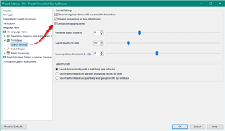

    You need to check this option "Allow overlapping terms":
    Trados Studio project settings dialog box with 'Allow overlapping terms' option highlighted in the Term Recognition section.

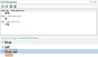

  • You should see red lines for all languages if the terms are recognised.  The problem is the lack of word delimiters and this can reduce the effectiveness of the term recognition.  So for example:
    Trados Studio Term Recognition window showing recognized terms 'blue' and 'blue cat' with red overlines, but missing the term 'cat'. Japanese characters are visible in the translation segment.
    Here I get the word blue which is in my termbase, and "blue cat" which is also in my termbase.  Using the overlapping terms options gets me them both and you can see the red overline splits the terms.  However, I don't get the word cat which is also in there and I think this is because it's not at the start of the string.

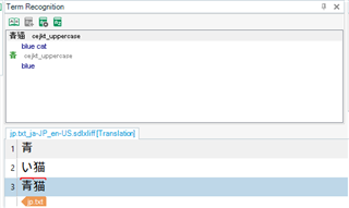

    In English I see them all recognised and displaying all three matches:
    Trados Studio Term Recognition window correctly displaying all three recognized terms 'blue', 'cat', and 'blue cat' with red overlines in English translation segment.
