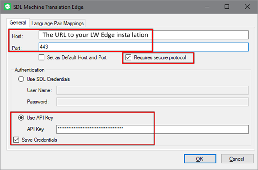

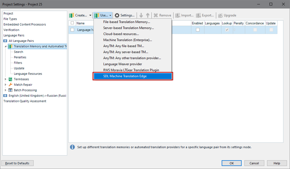

    With the current studio plugin, you can already reference a specific Edge language pair and specify a dictionary that needs to be applied on top of the language pair.
    Multiple dictionaries are supported per Language Pair, so you can define a dictionary for each category/domain you're working on and select the appropriate dictionary based on the specific project. This can be enforced for each Language Pair Mapping in the Studio Plugin.
    If you already have domain specific translation memories, you can also train multiple adapted Language Pairs, one for each domain and select the appropriate one in the Studio template. And Dictionaries can work on top of generic or adapted language pairs.
